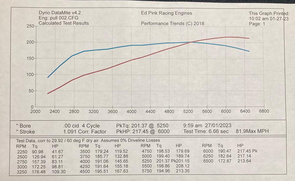

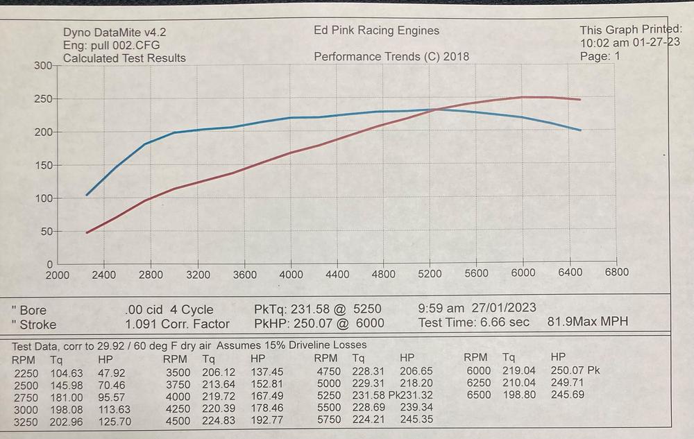

    Visited the hallow grounds of Ed Pinks today to make some power runs on their chassis dyno. Touring that place was like a kid at Disneyland - incredible history there. I saw many motors being assembled, from motors for Singer, Emory Motorsports and even a 917 flat 12 for Seinfeld. Crazy. Sad part is LA is forcing them to move so they can demolish their building to build bus stops for the Olympics. Glad I got to go to the original shop before they relocate.
    Now the fun part. My 2.5 put out a very surprising and impressive 250hp and 232tq at the crank (accounting for 15% drivetrain loss); 217hp and 201tq at the wheels. Torque curve is exactly what I wanted when I chose my cams and the HP comes on much lower than a peaky cam would - yes, I lost some peak HP with these cams, but didn't want to rev high to get torque and HP out of the motor - this thing is really drivable through the streets and freeways here in SoCal. Still can't believe these numbers out of a 2.5 liter that doesn't have modS or more aggressive cams in it (I went with Mod Solex). With my car weighing 2,133lbs, this is a power to weight ratio of 11.7, or 10.2 if measuring power at the wheels. Not bad for a mild and very drivable hotrod with only 2.5 liters. MFI is pretty well dialed in - curves were mostly smooth.

    Wow, that's a lot of torque for a 2.5L. Do you have a build thread somewhere?

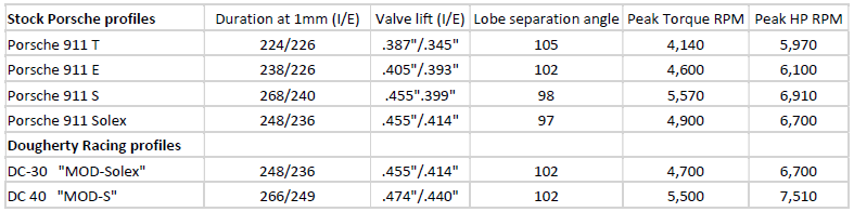

    Thanks - yes, the torque is exactly what i was looking for when i built my motor. here is my build thread - warning, it is very long!
    https://rennlist.com/forums/911-foru...rod-build.html
    Here are the specs to my motor:
    - 2.54 MFI Longstroke
    - 9.5:1 compression
    - Single plug, stock ignition
    - 87.5 slip-in LN Nickies cylinders (this gets me to 2.54 liters with no boring needed)
    - JE pistons
    - Dougherty Racing DC30 Cams (which is a mod Solex cam - see below for specs). Many discussions with John Dougherty to arrive at this decision based on where I want my power range.
    - Intake and exhaust bored to S/RS specs (36i/35e)
    - Heads were ported and polished by Ollies
    - Case was done by Ollies - oil by pass mod, inserts, align bore, etc
    - Throttle bodies by Matt Blast, stacks by Aaron Burnham (bored to S/RS specs)
    - Modified MFI Pump to match motor specs by Mark Jung
    - Stock rods, but they were balanced along with the crank, flywheel, pressure plate, etc by Ollies
    - ARP rod bolts and flywheel bolts
    - Mahle Clevite Calico rod bearings
    - Oil pump is Glenn Yee Motorsports GT SERIES 1 port and polish
    - SSI heat exchangers and Dansk sport muffler (dual center out)
    I was hoping for something in the 190-200hp range with a broad, usable power range - and finally, I wanted it to be reliable and very drivable. So far, this is how things have shaken out - but with more power and torque than i expected
    Being a long stroke improves torque, as well as the increased compression ratio, and I was careful not to over cam the motor -- based on where i expected to spend most of my time in the RPM range. this is not a race motor where i would be at high RPMs and speeds regularly. so for this reason it does run out of breath after 6k RPM - but everything below this is strong, usable power. This is another reason I was ok using stock rods (rebuilt and balanced though) - this is not meant to be a screamer motor.
    The data for peak torque and HP were approximations based on my research - however, the dyno showed different results for my car.

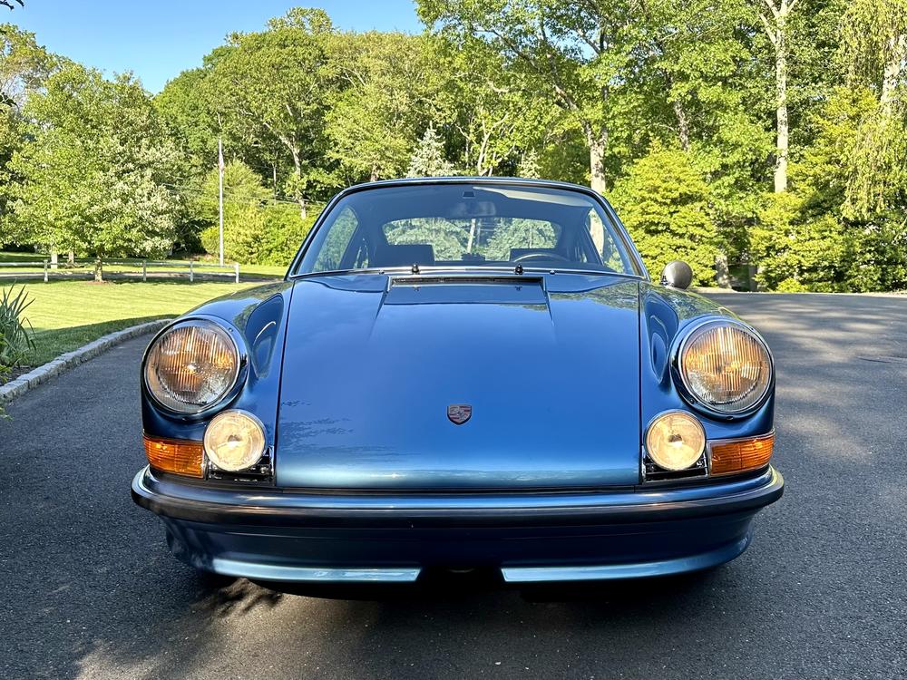

    Drove her for the longest most spirited drive of the season. Good news - no issues and the high Idle when hot has disappeared. She ran like a Top.

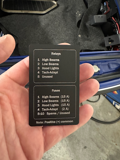

    Laser !
    Used my new laser to make an NLA gasket for my steering rack. Then made some anodized and etched aluminum labels for my custom fuse setup.

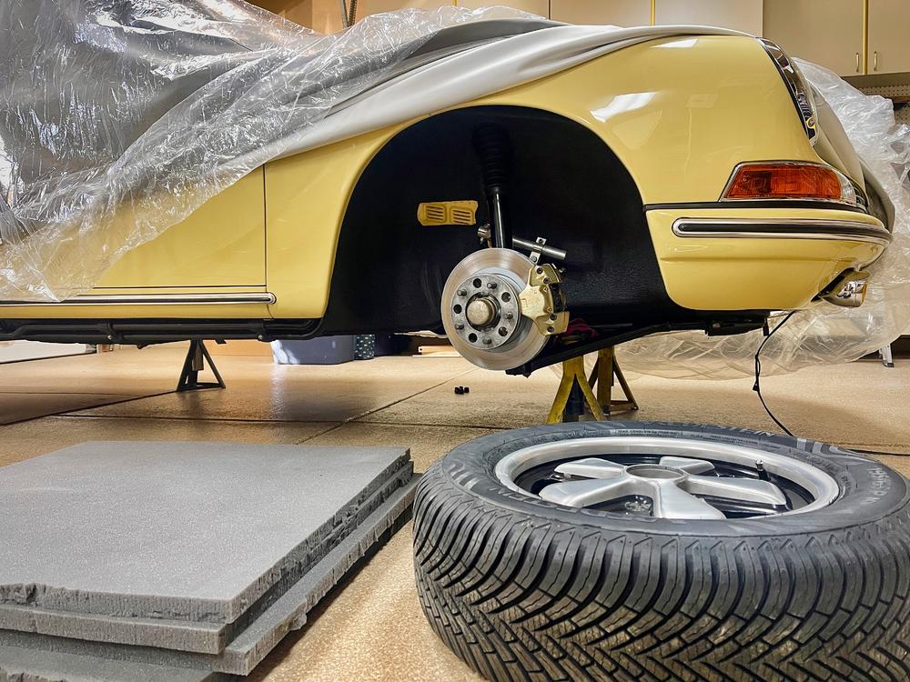

    New tires for my ‘65 today on the driver wheels.
