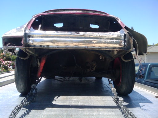

    More pictures of the first day
    Damn, what a pile!

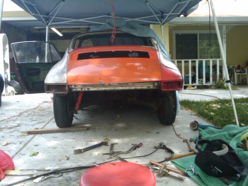

    First thing to be done: reattach the right rear corner.
