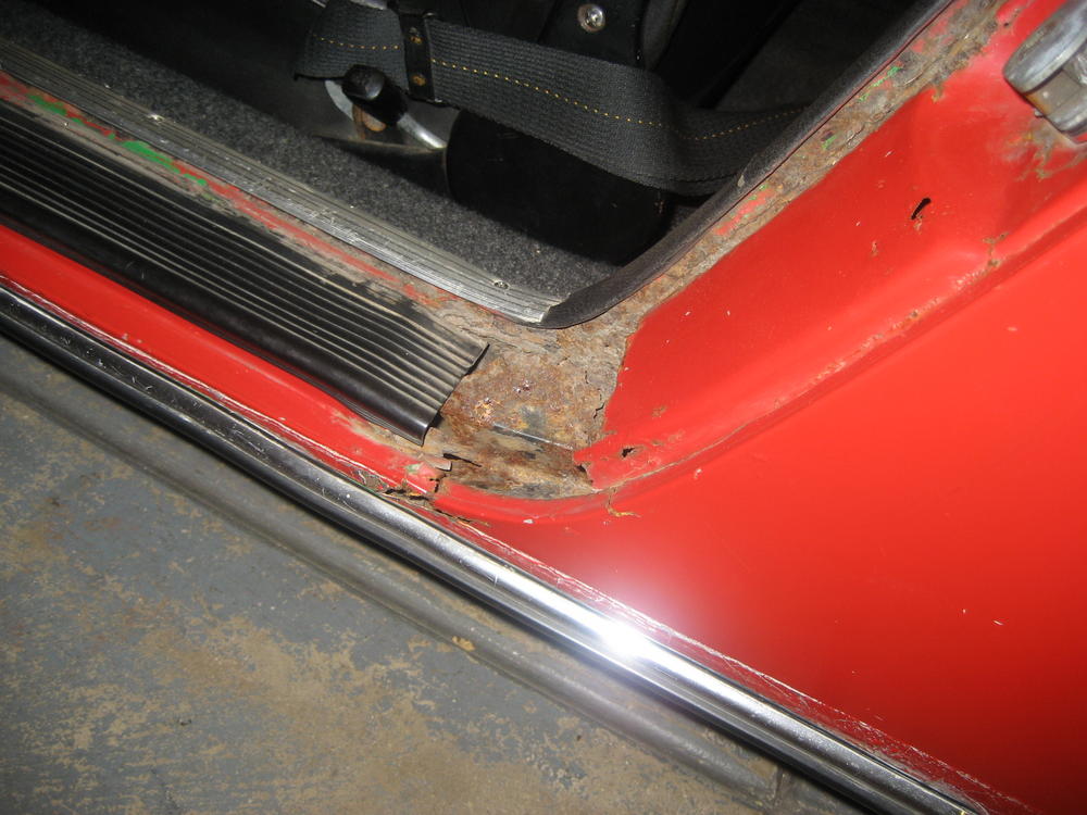

    I got a replacement headlite bucket from Stoddard and it fit well. Looks like your E has more rot in the sills than mine. I was able to cut small sections out and replace w/ small patchs. Sorry I can't offer advice on the later door sill part.

    Wow, quite a TR proj. you are completing there. I know the SC outer rocker is different and I have heard that Targas were made out of thicker steel in some areas too. PM sent.
    Well me and the screwdriver had a date tonight...
    The 3/4 trim was the only thing holding the outer rocker to the rear fender...

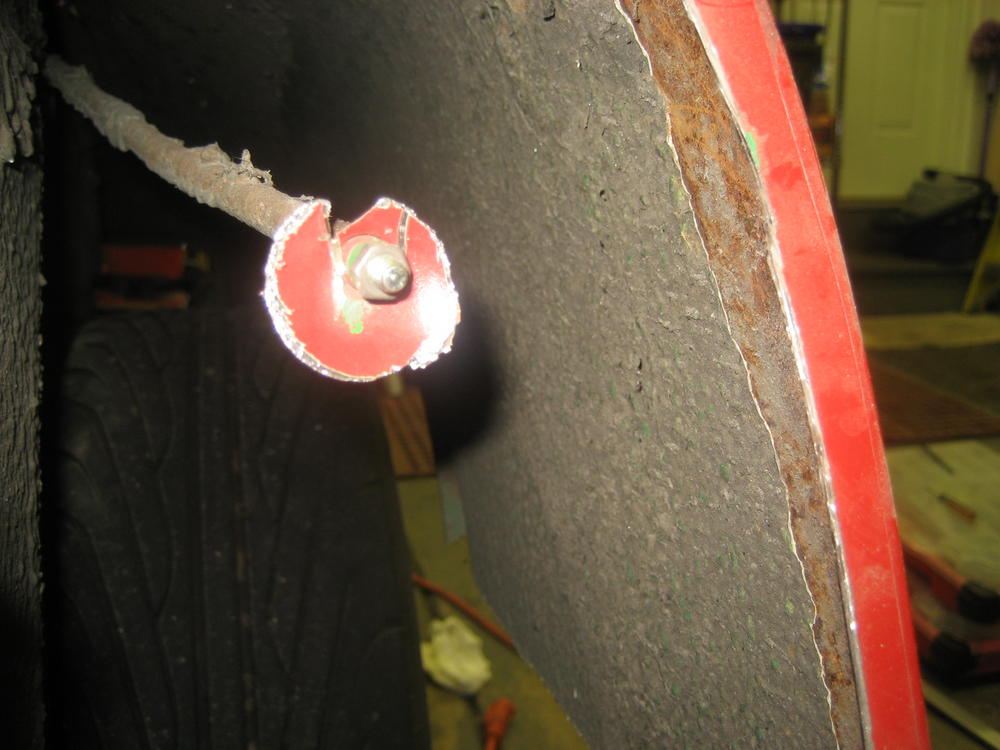

    Rough German assembly workers...crack'n my door panel...
    Inside door presents...
