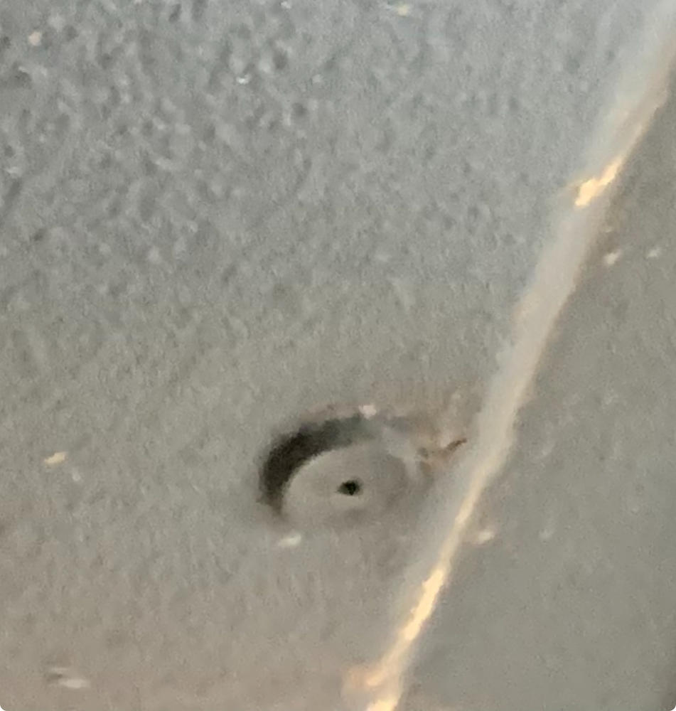

    This is a very original 73 I took photo of but I didn’t take measurements on the visible parts of the bung ( shame on me):
    Unfortunately based on quick check the paper factory maroon parts book of 72/3 doesn’t seem to show the bungs on line drawing or listings in relevant section.

    Clyde
    I just measured my original ones and they seem to be 14 or so mm on the top as fitted
    so I guess the hole they fit into would be a couple of mm smaller
    maybe if you have 12 mm ones they might just need a bit of lube and a rubber mallet to get them to fit in ??
    I suspect smaller than 12 mm would go through the hole or fall out
