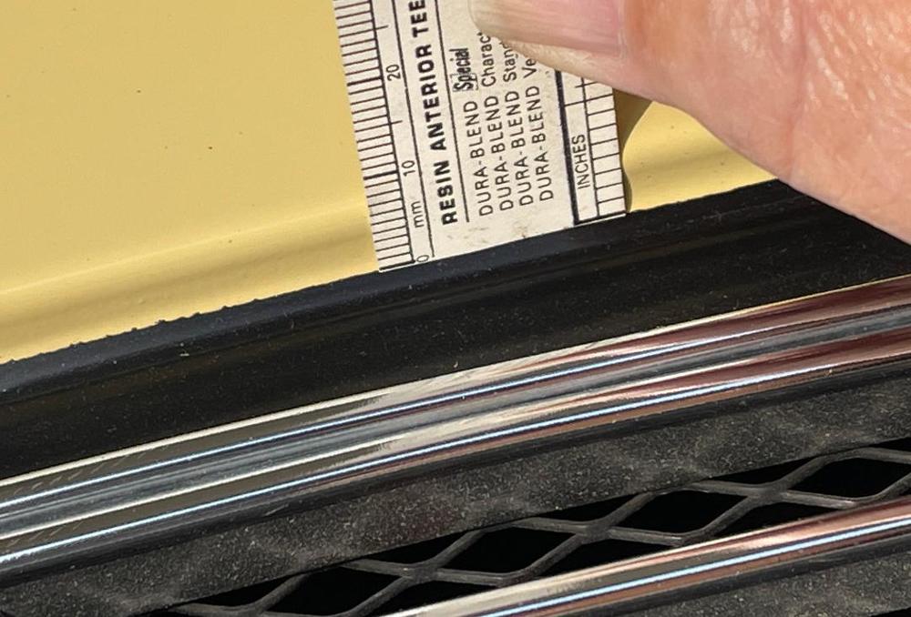

    - rear deck lid under grill should be painted flat black (although some say there are examples where this is not the case). I'm still waiting for photo showing actual paint line (can anyone provide?)

    Good start John. I'll try to post a photo of my original paint on the deck lid with black line.

    This is the original paint on my '65. Hope this helps, but I'm sure they are all a little different.

    Thanks John there's a clear delineation. Much appreciated!
