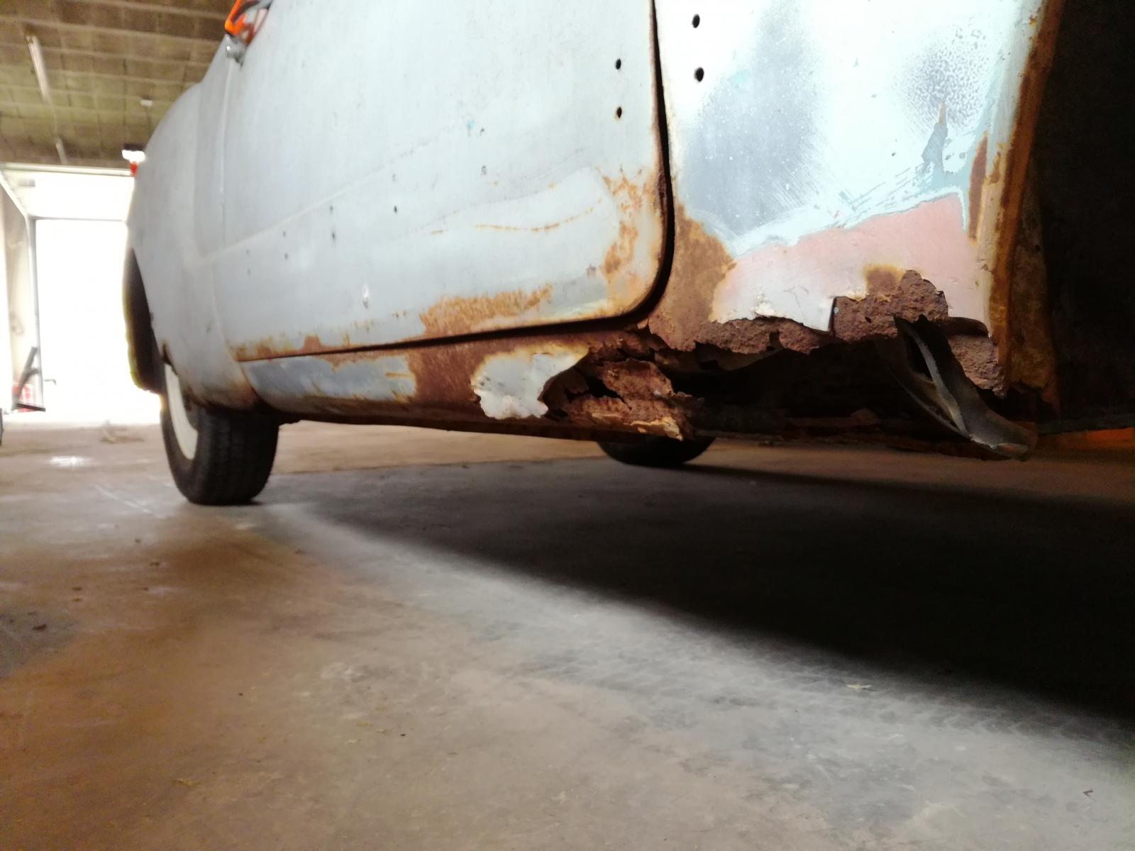

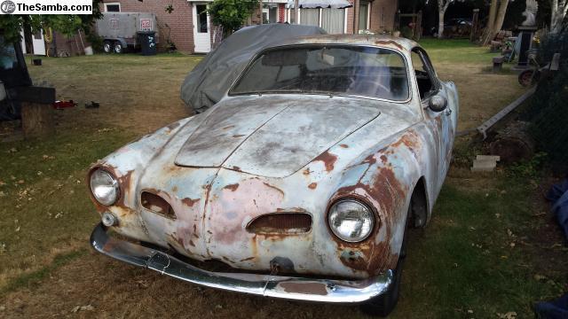

    But back to this topic: I bought in September 2017 a 60 (sept 59) strato blue ghia on the samba. Originally from Portland, Oregon but I bought it already imported. As the pictures were showing, it was in poor condition (and still is..) but I decided to save it. It will end up as a vintage/oldspeed restored ghia.
    Here is a picture from the ad:

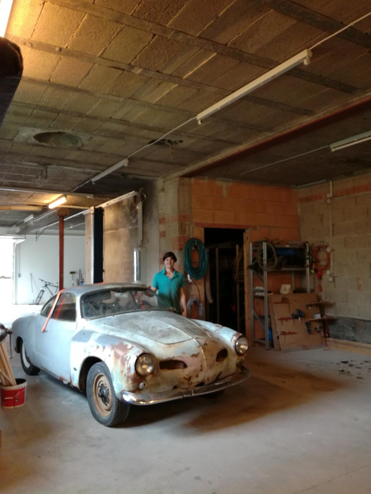

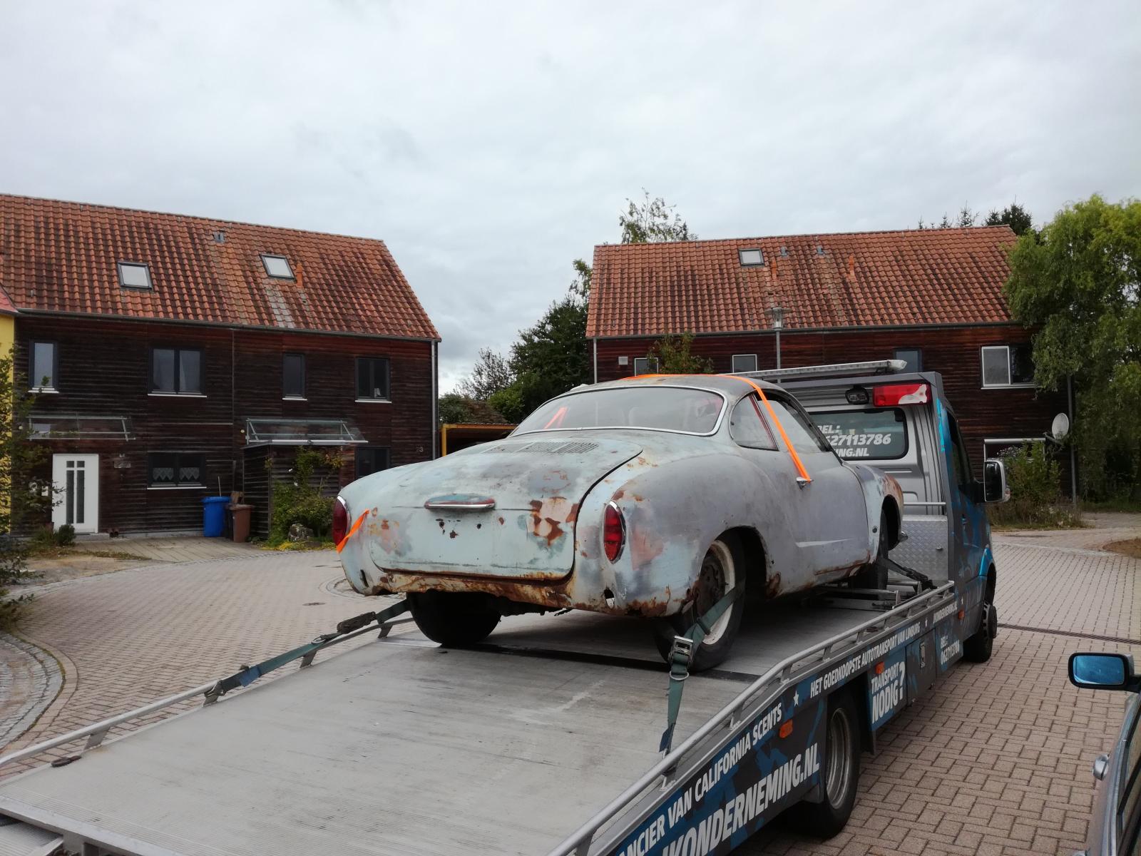

    And when it came home:
    I am of course already much further, although far from finished, and if you want, I will first update up to today's status and then..well, continue to update but slowly as it progresses

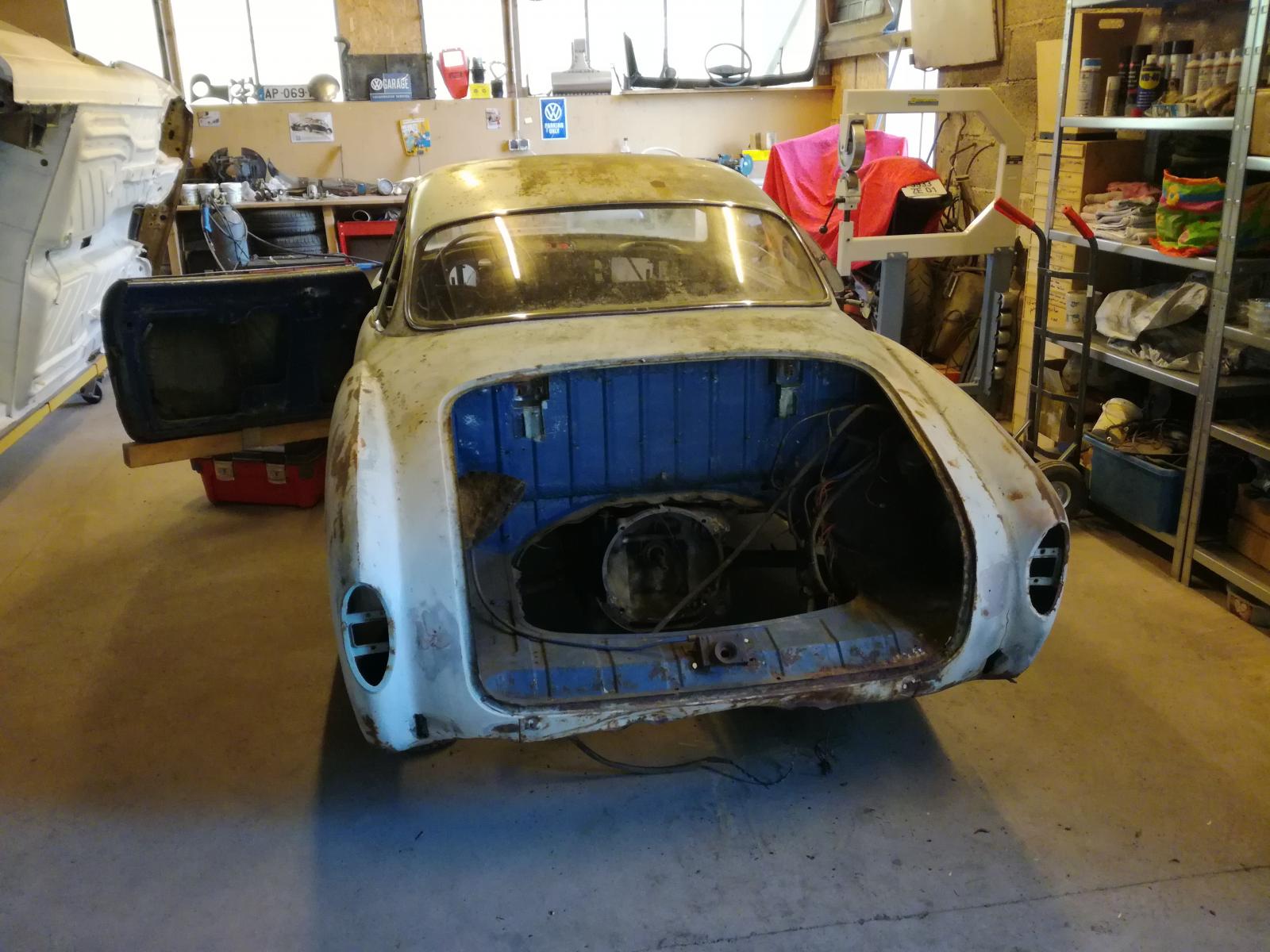

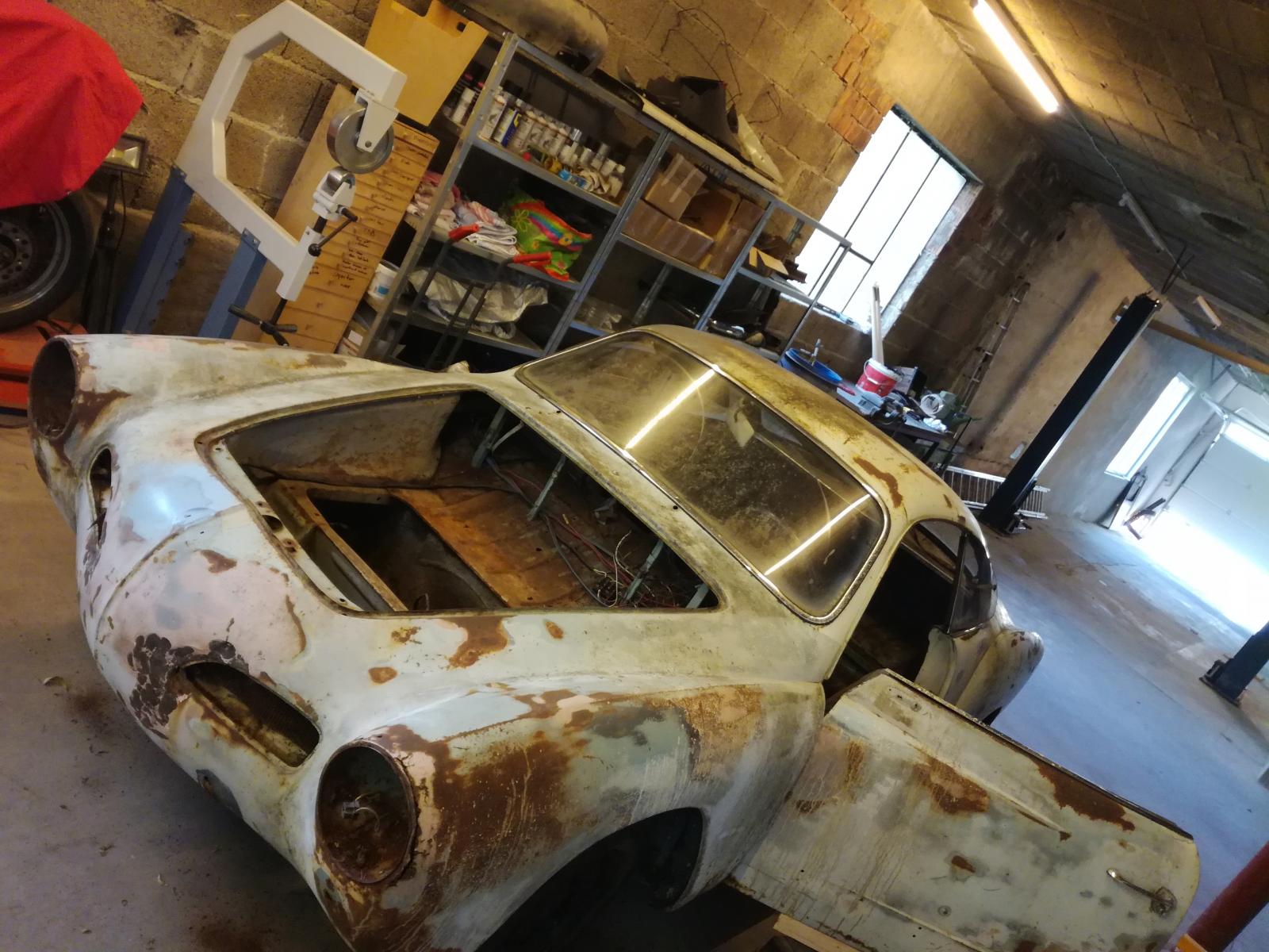

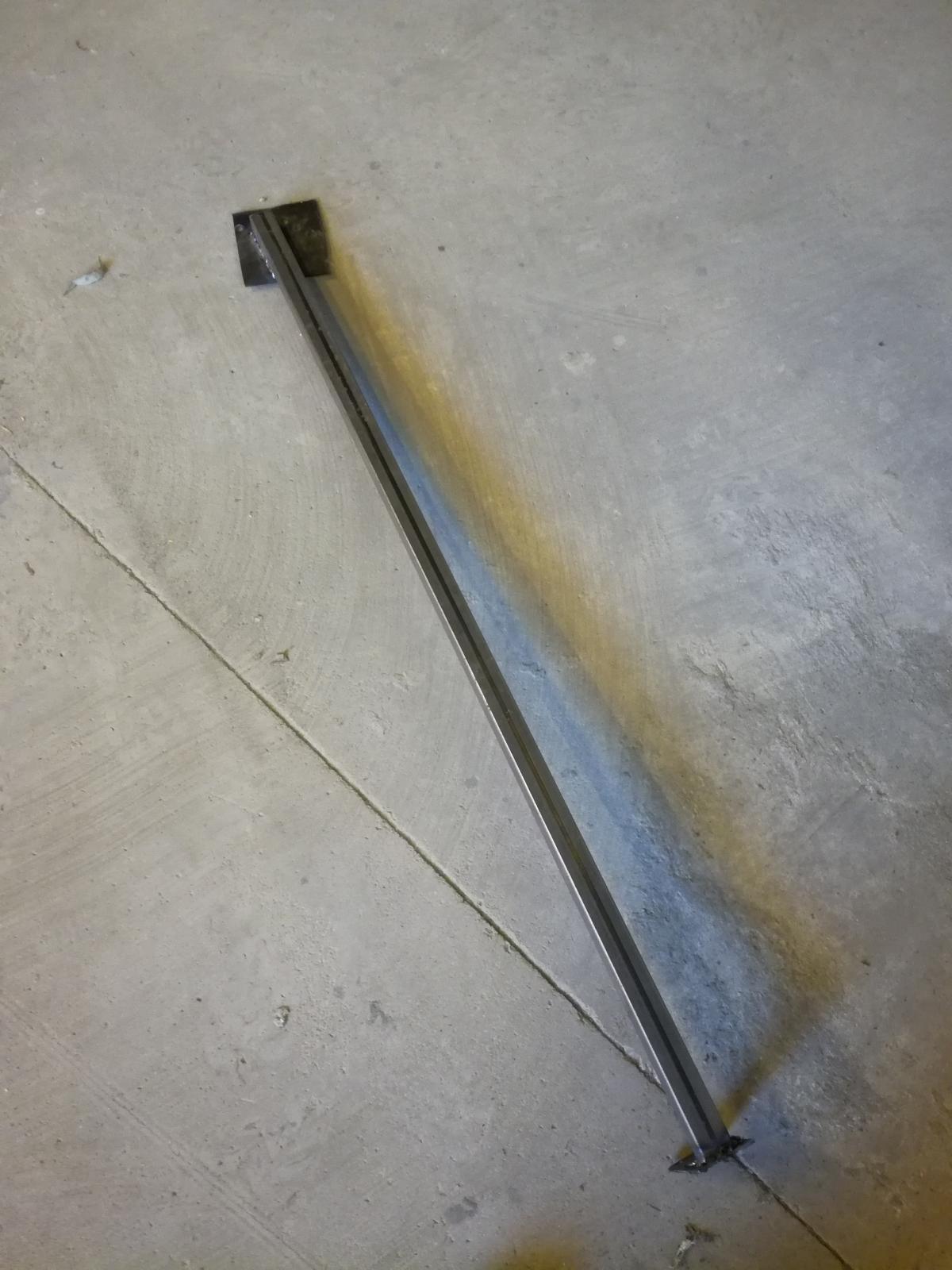

    So, after its arrival, I did a bit of disassembly and created some reinforcement to "replace" the doors:

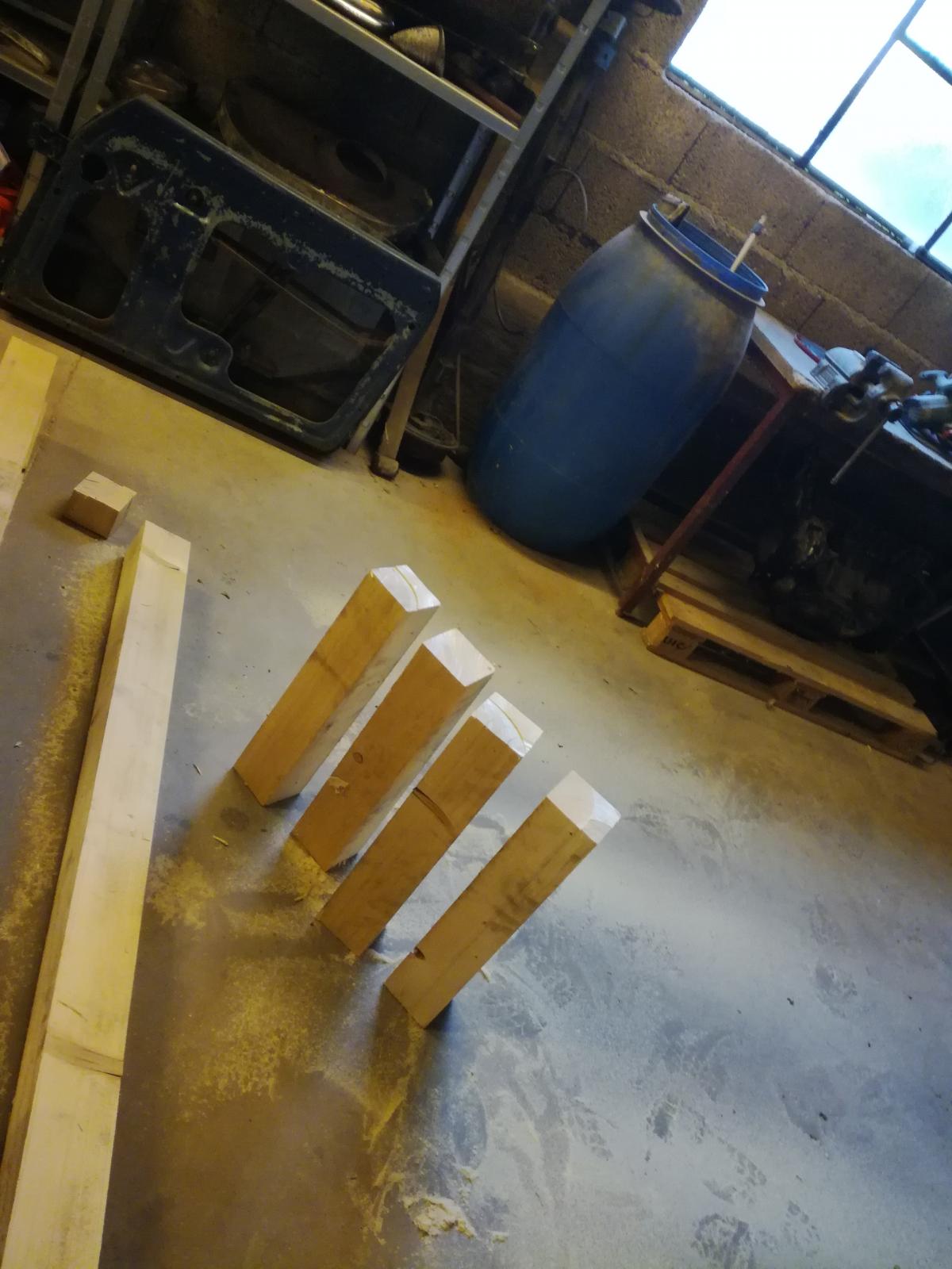

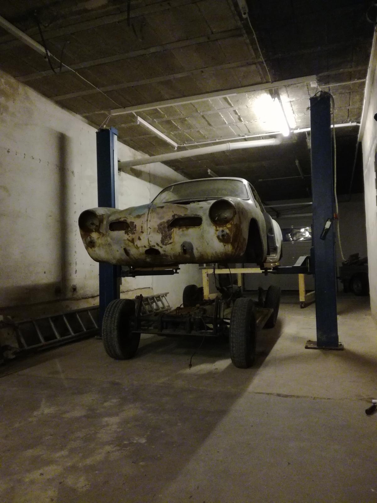

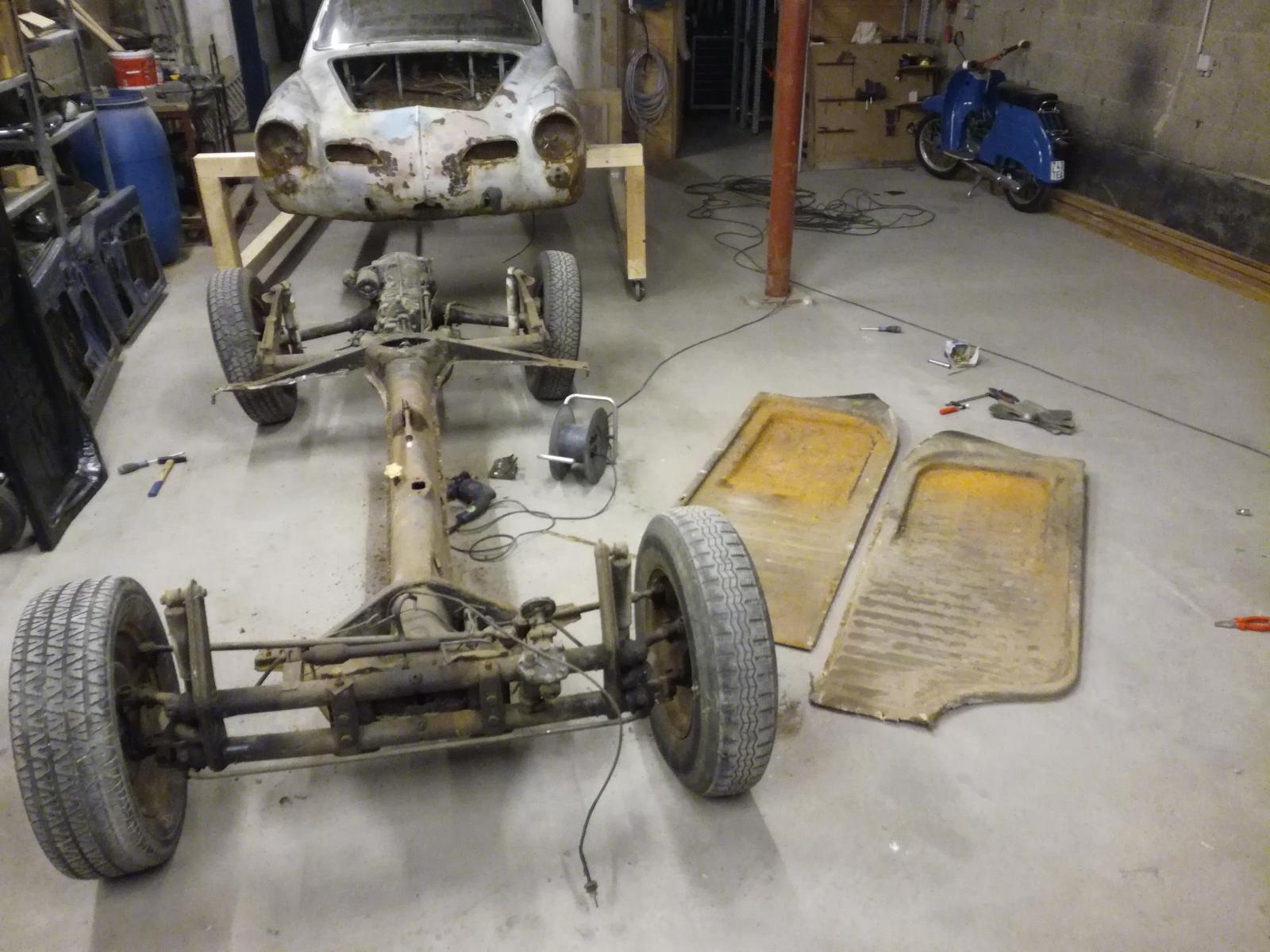

    And then it was time to build a dolly and take off the body:
    Now you can enjoy the view on the terrible fiberglass pan riveted by the previous owner :shock: :evil:
