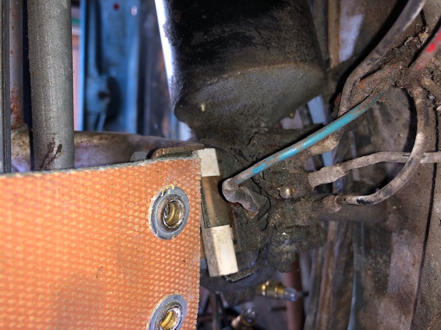

    Partial help? my 1971

    I’m still trying to figure out where the black and brown wire go. I see one of the suppressors has a red wire? Brown should be ground. But the black I’m unclear. The black wire can’t be unplugged but the brown wire can.
    1970 Irish Green 914-6 w/2.2S
    www.reSeeWorks.com
    Red from 53a replaces the brown on the capacitor (shown in that little box) black goes to 53a
    Brown goes to a terminal on the body of the wiper motor (ground)

    Thanks Timmy,
    It works perfect.
