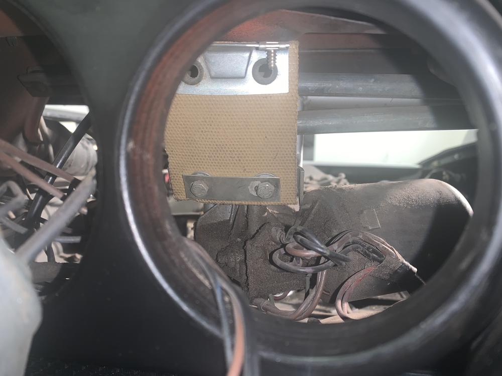

    I'm trying to diagnose a "no park" issue with my wipers as well, and this thread is very helpful! I don't hear the follow up/park relay clicking, so it seems that either it's not getting the right signal or it's dead.
    can someone with a better understanding of the relay setup and/or of how to read the wiring diagram for this setup shed some light on how the park relay activates and deactivates? thanks!
