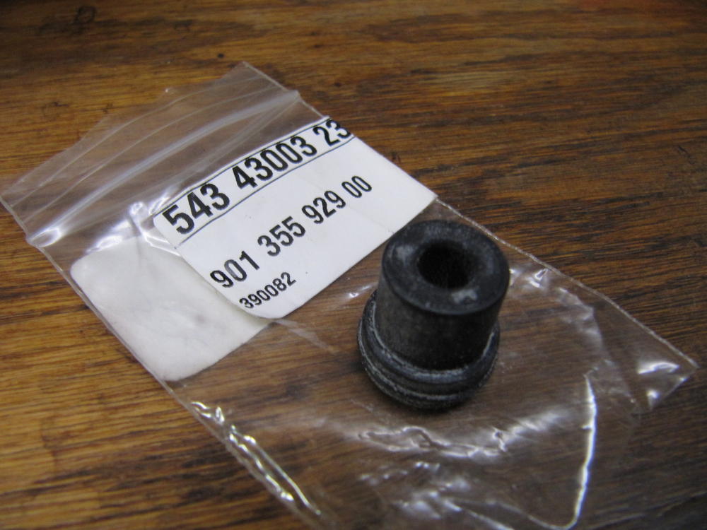

    I need some help...
    What part is used to connect the master cylinder and the brake fluid reservoir? Two plastic tubes descend into the bodywork from the reservoir, but I can't tell how the tubes are fastened to the master cylinder.
    Thanks, in advance for your help!!

    Here is the part. It is a rubber grommet and a bitch to install if the master cyl is still in the car.

    Jim B, reading your thread above, install the rubber grommets on the M/C PRIOR to installing on the car.? Do the reservoir down tubes easily slide into them once the M/C is installed.? Doing a whole new brake set up on my 71, and this thread couldn't come at a better time. Thx

    The supply lines are fairly easy to install with the master cyl on the bench. Yes, install them on the bench and then install the master cyl in the car with the lines attached.
