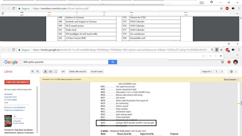

Hello, maybe someone with knowledge in the subject could throw some information of what is this extra code 569. Is it a package of anti-fog as I have seen in various books? Regards!
Looks like front and rear fog lights. See here. (Google is your friend)
https://www.porscheclubgb.com/PCGB/m...s.pdf?ext=.pdf
Bob B
Thank you, Bob. Porsche France indicated this extra in my father's car as Amortisseurs de pare-chocs AR from there asks me. I have seen several books in which this extra is named as a group of added lights ... Could it fit with the perforations that my 911 has on the front bumper? As you see?

You have to be very careful. Many option codes were recycled, so you have to be very model year specific. I would tend to believe printed matter if it was correct year.
If the option description from France is correct (Amortisseurs de pare-chocs arrière), then the rear collision bar is a close translation. The "Tell us how you want it equipped" page is a 1972 option list, and 569 was not on the 1971 list. So this is consistent with your car.
the three holes in your bumper, if that is what you are asking about, they look like what a guy would do in his garage to hold his bumper up that was sagging. he would just drill holes and put a few screws in. I have seen it often. it was a cheap effective fix, but not factory.
Thank you very much for that information, many will know those details due to the intensive use of their cars! These are details that are learned by word of mouth or simply by logic, something that I have not applied in this matter because as you say is an economic and fast method to solve a problem. I will try to see where these screws you are commenting would go.
I have checked what Scott A has told me. And he is absolutely right! Thanks to this I have also realized that the deformation in the front corner may be due to the metal arm that supports the bumper that at some point hit in this place breaking (according to what I think the defense and the arm) with its consequent repair!
