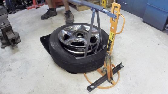

A manual changer often takes significant effort to break, dismount beads, but satisfying when finished. After dismount, you don't need professional plugs, so long as you roughen the inside of tire with rotational stone grinder for drills. You do need a quality adhesive, which weatherstrip seems to work well, so long as your soft rubber material follows the contour of a tire. A halogen work light, some heat will help bond things before remounting the tire.
Finished a repair just now, fresh insights may prove useful..
